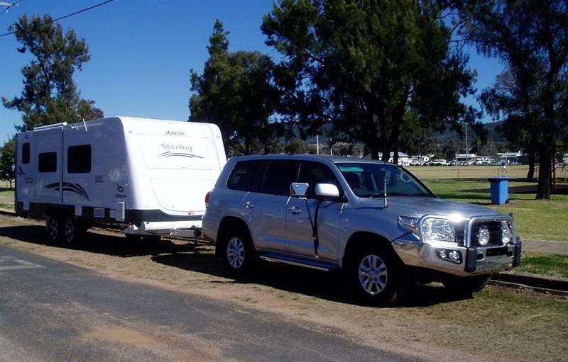

Dennis Ellery posted:
NTVRX
Looking at the photo on your post – you caravan is a baby and it only needs a small airconditioner.
My caravan is 24’ and a 2kva genset (with a 1.6 KVA continuous output) is not going to run my air conditioner in the temperatures I use it. It might run it at 30 deg ambient – but I’ve seen them die at 40+. The extra 240volt cooling fan won’t do any cooling, as the Honda 2 is totally enclosed - so you are adding additional load for no benefit. I’d shoot the messenger.
FollowUp 2 of 6
FollowupID: 758478   Submitted: Sunday, Apr 15, 2012 at 22:14
NTVRX posted:
One should not assume Dennis old boy.....the photo is an old one. Fact. my caravan is not a "Baby" it is a 19'6' Paramount & yes yours is bigger than mine!!! My Honda 2 has powered my a/cond in low 40's....I don't doubt it won't run yours I cannot prove any different so I will take your s/ment on merit .....as I mentioned the info about the lead,fan etc....was supplied by a Honda tech. He sounded sincere to me....maybe you know better. Are you professionally qualified in generators Dennis? If so I will ask some interesting questions...it will save me phoning Brisbane. Shoot the messenger? Hmmmm!!!
"The difference between genius & stupidity is-genius has it's limits"
FollowUp 3 of 6
