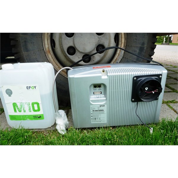

We bought a second hand one in Europe while we were touring there in 2014 and owned it for 2 years.
I would have brought it
home, but it was difficult (could not be flown) because of the possibility of residual methanol (not ethanol) inside, so we sold it there.
The fuel needs to be pure to avoid contamination.
It was installed under a
seat inside the motorhome. The exhaust is a little CO2 and some pure water. Slightly more noise than a compressor fridge, but it starts and stops to
check the battery voltage and that makes it noticeable. Would not be hard to install so it was virtually silent.
Great jigger. Saved our bacon when the house batteries failed.

The fuel is a mix of methanol and water?
What ratio, is it dangerously flamable like petrol or LPG.
A little CO2 in the exhaust. Enough to need an external exhaust vent?
Thanks for the input.
HKB,
Is that the size of the fuel container you mentioned in your post?

As far as I am aware, the fuel is straight methanol, which is highly flammable. The purity required is higher than commercial methanol (according to Efoy) which is why they insist on using theirs. The container in the
pic is 10L. It weighs more than the unit itself.
The exhaust is a 6mm diameter clear tube. It can be run into your
water tank, but it is just a little dribble. I doubt the CO2 would be sufficient to justify exhausting outside, but we did.
The output of ours was a constant 75W. There were other size units available. Amps reduce as battery voltage increases with battery SOC.
Ours (the one in the
pic) had an extra cooling fan (black one on the outside) designed for hot climates like Australia. Ours was actually purchased new in Australia and went to Europe in a vehicle by sea freight.
Efoy were supposedly developing some software that would eliminate the last remnants of methanol from the unit to allow it to be air freighted, but when we left Europe in October 2015 it was not ready.
