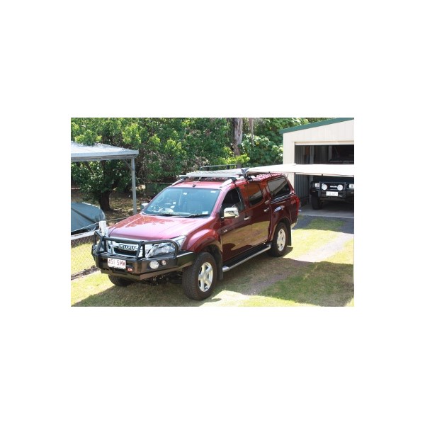

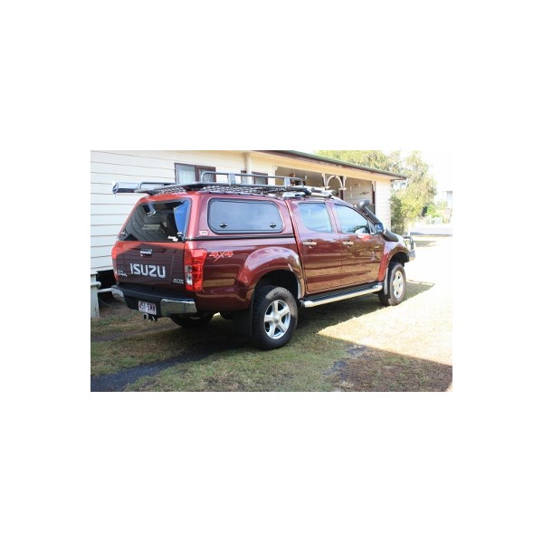

We found the original suspension is far from satisfactory the bump stops where shiny and you could feel every bump in the road, we now have a full replacement suspension and the ride and handling has improved 100%. A couple of photos of before and after.

Follow Up By: Member - Kevin S (QLD) - Saturday, Feb 09, 2013 at 17:04
The new vehicle is looking very smart, Bruce. Are you counting the sleeps yet?
