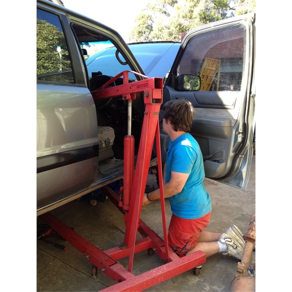

Recently an early Patrol slid backwards and rolled on a really badly rutted steep track late one week night.
The kids took the call dragging themselves out of bed and arrived on the scene around midnight.
A high level of capability was required and they took a 4800 GU Patrol which had just been fitted with 37 inch Maxxis and a prototype dual plate clutch.
The rescue was really hardcore and went on for hours involving 3 cars belaying the stricken vehicle down the slope inch by inch.
The 4800 GU took the main load constantly re-positioning itself and it was to much for the on/off prototype clutch which shredded its ceramic linings on the last section of the recovery.
The rolled car was however recovered and the 4800 was jammed into 3rd and limped back home about 4am.
So what to do ? - I'm not a mechanic and the manual box in a GU is a really heavy truck grade monster and relacing a clutch in it can't be done with home tools.
This is where I learnt something from the kids , I didn't have time to tell them it couldn't be done and before I knew it they borrowed an engine crane and some mates and shoved it thru the drivers doors and lowered the gearbox
to the ground - thanks to the huge tyres there was reasonable working area under the car and a couple of days later it was all over and cost nothing.
They did however leave plenty of oil stains in the driveway just to make sure the parents got involved.

Hi Guys
I was seriously impressed actually - I have done an earlier Patrol (which is lighter ) and never again.
When I got my 4800 manual done - it cost 8 hours labour which was more than the parts - now theres a thought , maybe this is a way the kids can earn some more pocket money.
The drivers side leaves a big space on the passenger side to work thru the tranmission tunnel hole Geoff.

G'day Robin.
Sorry, BUT,
Lots of people do repairs at home and a crane is often featured, no surprises there at all.
The only thing there is, I wondered why the parents didn't know how to, either do it, or know of the possibilities.
Perhaps no mechanical aptitude or abilities and low awareness of the features of the vehicle.
The reason the crane goes in the RHS is because it is thinner than a human and the human attending can get into the zone through the LHS. The steering wheel would prevent the human from easily accessing the top of the work area.
This way it will work.

Follow Up By: Robin Miller - Wednesday, Feb 13, 2013 at 11:27
Yes Olsen , that huge box can't be taken directly out even with a proper transmission jack , it has to be manovered past the starter housing in two stages.
Hi Ross
The parent (me) isn't completely without mechanical ability but I am
to logical an engineer not to access the risks up front and decide to let someone with the right equipment do it - but the kids have no money and to some extent work within these constraints and come up with some surprizing innovations espically when you consider this is their first.
They even used a heavy duty bike tie-down instead of a chain to hold the box to enable extra adjustments that need to be made independant of the engine crane.

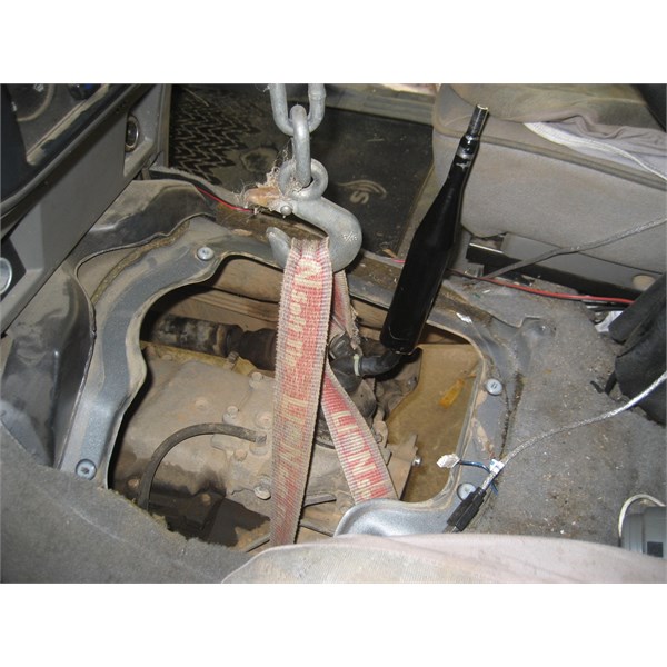

G/Day Robin, They did well, Nice to have a good size acess panel there to!, good thinking Nissan!,....Yes we do learn from our kids as we get older,Whatever you do don't stuff the clutch up,"..or your on your back with that monster dangling over the top of you..LOL.!
Cheers Axle.

Hi Axle
Yep easy to work with but its a dubious advantage , the transmission tunnel is wider than 100 series so less sideways leg room.
Before it was finished it was driven with the shroud off that gearbox hole and on a hot day it was unbearably hot with air flowing in direct from extractors.
