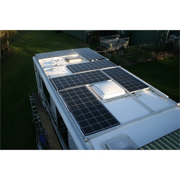

Allan, the batteries are probably Ritar 100ah, as I have a Sterling Outback also.
Here is an image of my setup comprising six 135watt Kyocera panels (2 x 3 ) on two seperate circuits (a dual system) Seperate cabling leads to two 25amp Sunsaver Duo controllers, one circuit supplies solar power to the above batteries for house power, and the other circuit to a Fullriver 150ah dedicated compressor fridge battery.
It is a proven system and you can never have enough solar panels, if you are serious about bush camping, away from the umbilical power cord of caravan parks.
