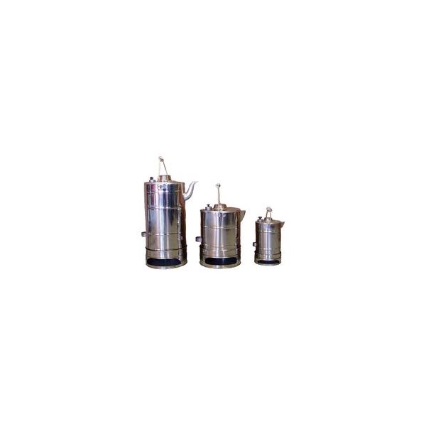

Reply By: Phil B (WA) - Tuesday, Aug 20, 2013 at 10:04
Hi Guys
Try one of these
See here for more. There are others brands around Eco- billy and Dingo from memory.
AnswerID: 516763
Follow Up By: olcoolone - Tuesday, Aug 20, 2013 at 13:13
We have one of the original Eco-Billy 1.5lt kettles and love it, we use it all the time when travelling.... a hand full of small sticks/twigs and your away. It boils quicker (less than 3 minutes) than the time it takes to make lunch.... and it works fantastically on the fire.
Most friends we travel with also use the Eco-Billy.
We also have a high tech expensive gas burner that we use if cooking on the go.
Electric kettles are a thing of the past and a waste of money.
FollowupID: 796221
Follow Up By: Member - Wozikev - Tuesday, Aug 20, 2013 at 13:22
Hey Phil - have you got one, is it reasonably rugged and are you happy with it? I ran into an old character at Niagra Dam years ago and he had a home made one (galvanised) and he knocked me up a brew in a matter of minutes. They're just so amazingly fuel efficient, and half a shovel of coals does the trick. I always look after my gear, but they need to be reasonably robust and travel well. I didn't know they were available commercially, you've done me a great favour. I will do some more homework on the 3 litre model I think.
Thanks heaps Phil and fair weather. Cheers................. Kev
FollowupID: 796224
Follow Up By: Member - Boo Boo (NSW) - Tuesday, Aug 20, 2013 at 13:32
Our Dingo stays in the dmax and is used all the time.
Would not go back to the canister stove.
FollowupID: 796227
Follow Up By: Phil B (WA) - Tuesday, Aug 20, 2013 at 15:13
Hi Kev
Yes I have one - a Royce, very pleased with it but the metal is a bit thin - so can't just toss it into the back of the vehicle. Maybe Eco Billy or Dingo is more robust.
FollowupID: 796243
Follow Up By: Member - Fab72 (Paradise SA) - Wednesday, Aug 21, 2013 at 14:07
G'Day .. I also have the Eco Kettle...the large one. Saved me a buck load of $$$ when we went on our outback odessey with the kids. Can't beat 2 minute noodles and Easy Macs for lunch.
As stated, it boils on a handful of twigs, leaves or a couple of sheets of newspaper.
In other situations, it can be used on top of a gas burner by covering the centre hole (boils even faster) OR if no leaves etc are available, a piece of Jiffy fire lighter..
Cool down time is super quick too, meaning you can throw it in the car and go.
Fab.
FollowupID: 796361
