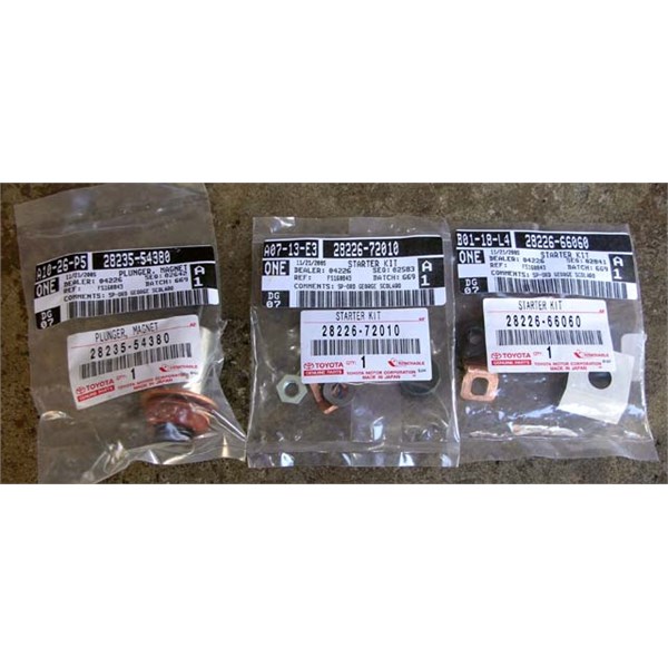

Reply By: Member - Bruce C (NSW) - Sunday, Oct 06, 2013 at 15:43
The problem with Landcruiser starter motors is well documented and relates to the contacts only. They are not heavy enough and there is aftermarket larger contacts available for them and it is a simple enough job to fit them if needed.
Here is a pic of the required parts and part numbers.
Cheers, Bruce.
AnswerID: 519272
Follow Up By: allein m - Sunday, Oct 06, 2013 at 16:29
thank you for going to the effort of punting pictures I will not see my friend till tuesday but at least now i can give a decent answer to the question
I really do appreciate the answers thank you
