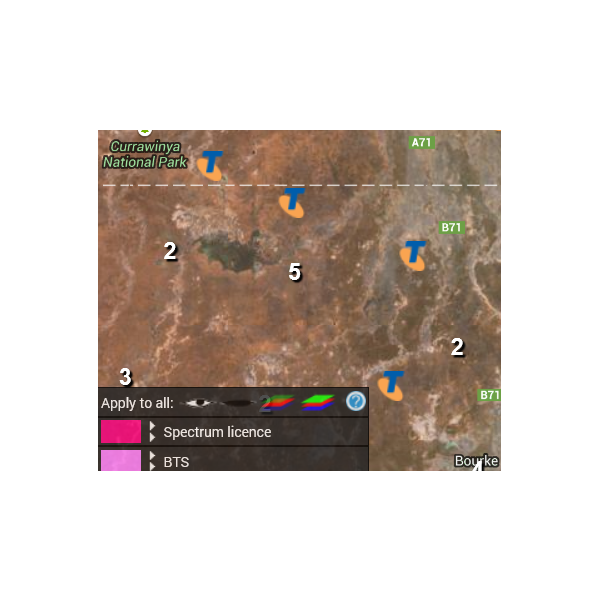

Follow Up By: George_M - Thursday, Oct 24, 2013 at 17:26
You may well have been very close to a tower, Bob.

Follow Up By: Member - Boobook - Thursday, Oct 24, 2013 at 18:10
A Re-radiating antenna is great for simplex transmission like GPS where the signal is focussed for reception. But it won't help 2 way conversations of phones. Must be a local cell.

Follow Up By: Echucan Bob - Thursday, Oct 24, 2013 at 18:31
George, Boobook
I think you are right about there being a local cell out there. The Telstra coverage map that I saw shows a service at Enngonia which might reach the B-H road.
Where is the map that you posted from George?
There was no service at Hungerford (as suggested by your map), and there was only the brief window that I mentioned.

Follow Up By: George_M - Friday, Oct 25, 2013 at 09:48
I used this website, Bob.
There are a number of others, and this one is mind-numbingly slow.
