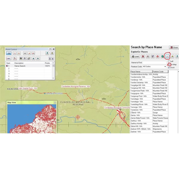

Is there an easy way to mark all Places available through Name Search onto the EoTopo maps, and if so, how is it done?
I am using Ozi Explorer.

You can have them all marked up on the Ozi PC version easily enough.
Just select the plot location icon and tick "on map".

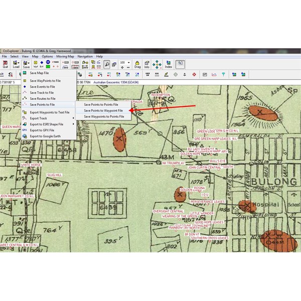

You can save these points then, though as the maps are fairly large you will have quite a few points. An option is to select a map in area of interest that is of a smaller scale first to reduce number of points.

Good stuff Alan - didn't realise you could plot all points on at map at once...though as you mention can end up with way to many points if you use large area (e.g. small scale map)...but anyway, once points are loaded you can save them as way-points..
You do however lose the feature code from name search file in the process (river, lake, town, etc) and just end up with a name. Process also truncates longer names. Significance of this depends on if you need additional info I suppose.
