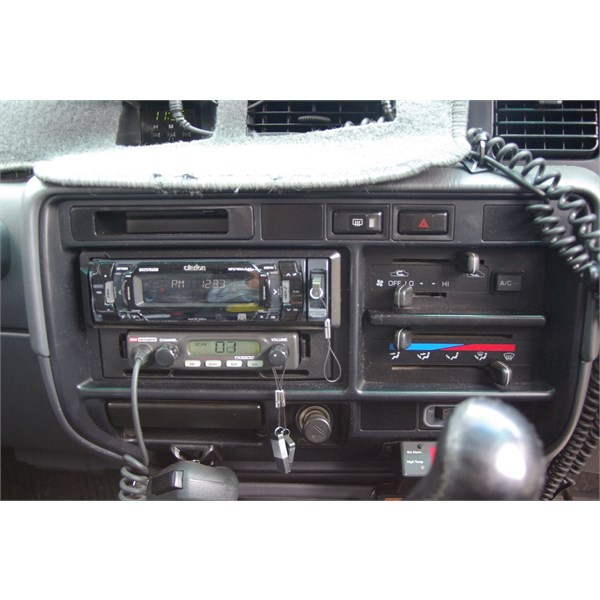

I fitted a new (in 1998) cd/radio in the top half and a GME UHF below it. Fits like it was meant to be.
Ian
AnswerID: 530352

I fitted a single din radio and a GME uhf underneath.
Gme made a single din facia filler to suit, unless you have a din size uhf then easier.
was a tad tricky to mount the uhf under the radio.
Make sure you can get a harness wiring plug kit to suit toyota to the brand of radio you buy it is then just a matter of plug and play, Aerpro make them link aerpro
