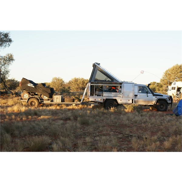

Reply By: Mick O - Friday, Apr 11, 2014 at 19:28
Not quite a dual cab but cut and stretched a 70 series ute then built pods for the rear as per profile photo.
Blog on the build to date is here.
Building the dream off-roader
Only thing missing is the details of the rear diff extension and the new axles.
Let the spending begin ;-)
Cheers Mick

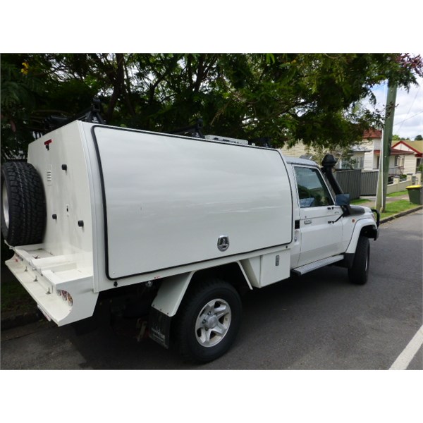

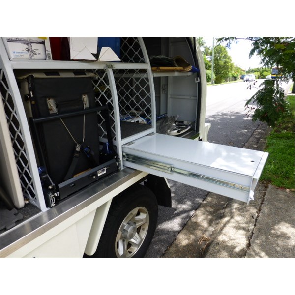

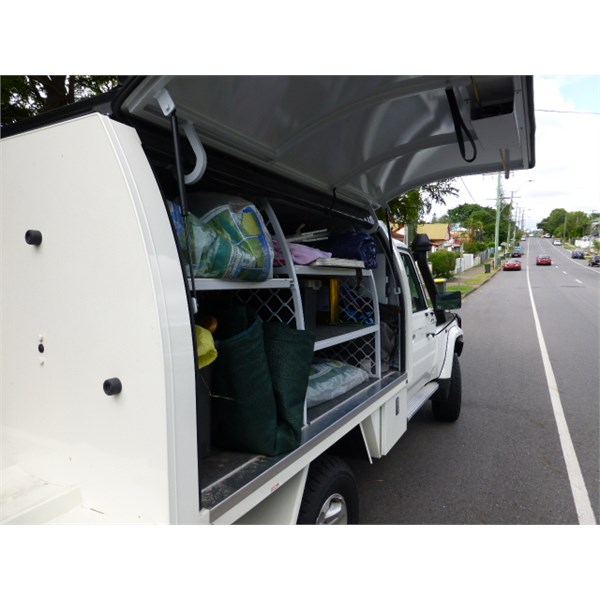

Reply By: Member - Rosco from way back - Friday, Apr 11, 2014 at 19:42
G'day Ken
A few ideas for you. Personally I get a tad nervous about a chassis extension, unless you plan to add another set of wheels.

Great set up mate, looks awesome very nicely finished, do you tow your accommodation, or rooftop .
Nervous due to the weight, that is increased on that original spot, potentially weak??
The reason for a extension is so I can run a big tray as I need a dual cab , with a small family. Room is everything.

Follow Up By: Member - Rosco from way back - Friday, Apr 11, 2014 at 20:01
We tow our accommodation. If you've won lotto speak with Multi-drive. They have serious 6x6 conversions for dual cabs with consequent GVM upgrade. Mega bucks though :o(

That's a magnificent job Rosco. Class work. If you don't mind me asking, who did it and what is the pod door sealing system?
Cheers Mick
FollowupID: 813271
Follow Up By: Member - Rosco from way back - Friday, Apr 11, 2014 at 23:01
G'day Mick
Totally Ally so complete unit only weighs 300 odd Kg (no tray, complete unit mounts on chassis). Automotive type seals which work very well.
Made by Trade Bodies in Caboolture. Very happy so far. Not cheap .... but then again you can't use cheap and quality in the same sentence can you?

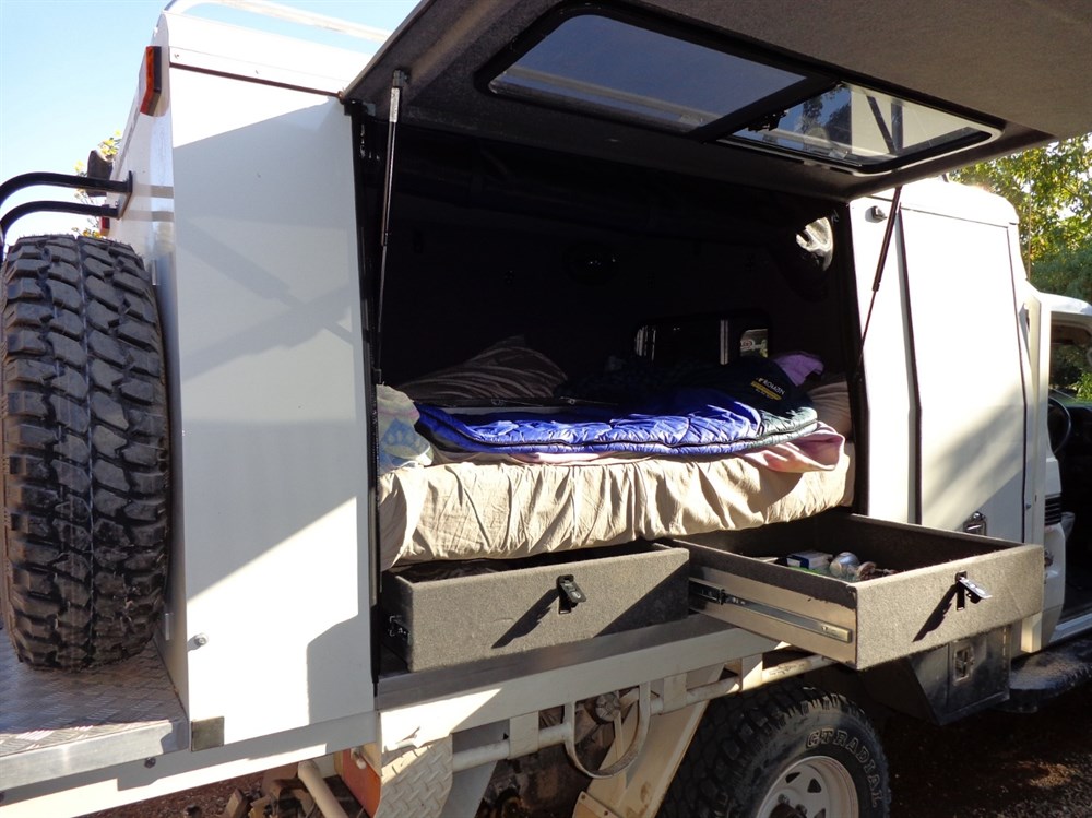

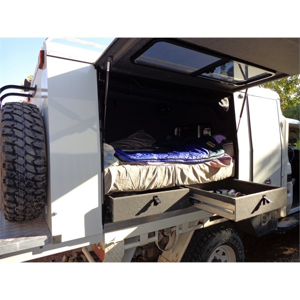

Reply By: Bob Y. - Qld - Sunday, Apr 13, 2014 at 17:39
Ken,
Have had a camper for just over 12 months, but it's still a work in progress. We hope to take it on a run up to Normanton, Cooinda, Darwin, Kununurra, Mitchell Plateau, Keep N/P, Lawn Hill N/P and Undarra lava Tubes, iin June/July.
We've done a couple of nights away in it, and I was "living" in it when my other accommodation become unavailable..........ha ha, no, not a domestic dispute. Most things seem to be working out okay.
Lately, in a very slow upgrade, have added a Redarc BMS system, 2 x 120amphr AGM batteries, and have a few extra lights and merit sockets to install. Still have a 60w & 160w solar panels to mount on the roof, and fit an external Anderson plug, to utilise a folding solar panel I made up.
Already have a s/s water tank fitted on the front of tray, but plan to hang an 80L poly tank underneath. Light are all LED, and the ones on the doors are touch lights. Bit funny to get used to, but throw out heaps of light. There's an extra LED strip light on the kitchen door, and a 2nd touch light in the bedroom. Have a 12v fan in bedroom, plus a Sony CD/AM/FM radio. A sliding window in the bedroom door, provides ventilation in cooler weather, or if you want the door shut for security. A roll-up insect screen provides plenty of air, but keeps the insects out. Split system aircon was a $3K option, but gave it a miss as we're not likely to travel in hot weather.
Have had to do a few other things, such as up grade the springs, for the extra weight, but this was needed anyway as the original springs were a bit tired.
Pretty sure there's another thread as well as the ones Dermie mentioned, extolling the virtues of these aluminium canopies.
Bob.
