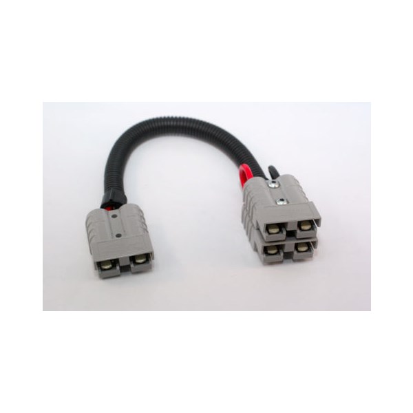

If I understand you correctly, what you seek is a means to connect both solar panels simultaneously via Anderson plugs. If so maybe this Anderson double adaptor will serve your need. Just plug it into the camper socket and plug in both panels.

Just be sure that all your Anderson plugs are the same size. This double adaptor uses 50A Andersons.

I was hoping I could use something like that. I just wasn't sure if I plugged the two panels into the double adaptor, whether the panels would be in parallel.

Yes Jos, when plugged into the double adaptor the two solar panels will be connected in parallel.

Yup the 2 into 1 is the method i used and it worked a treat.

I have now installed a 150W panel on the canopy of the Dmax and wanted to be able to connect this into the camper along with the other panels, I just had the sparkie install an Anderson plug at the panel, so I can disconnect it from the BCDC 1240 in the tub and plug it into the camper. I just use one of the above double adapters and it works ok.
