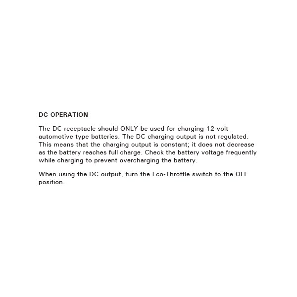

Brian, the following is from the Honda Owner's Manual and confirms what others have said regarding using the Honda 12V output to charge batteries. It can be done but it has the risk of overcharging if not carefully supervised and with the correct knowledge.

Thanks Allan ,
i stand corrected !
