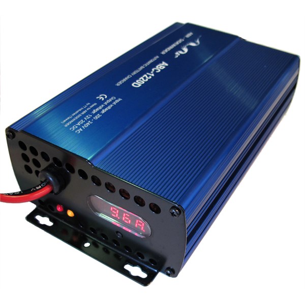

Yes no problem to charge both at same time via the VSR, I run a fridge 24/7 in my Prado and hook it up to our ABC1220 charger every night via an Anderson plug at the front.
Have a look at our ABC1220 it is a great charger.
PS: We also sell a mini diode booster that will fit the D-max but that is not your problem, I would get the alternator checked if the start battery is not charging.
Derek from ABR

Follow Up By: ABR - SIDEWINDER - Friday, Jul 25, 2014 at 20:00
The ABC1220 will yes. The Ctek 15A will also. I would not use anything smaller than 15A.
