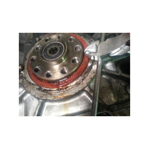

In the pic they maybe "didnt get it right" but Id be suprised if a seal failed most times when the surface wasnt roughened up-it hasnt for me?
Ive had a look thru our CAT workshop manuals for 3406 and 3516 and cant find any mention of it, contrary, to polish it as smooth as possible.

Generally most people can't replicate a "New" surface finish,
I never said "roughen up"
Not sure what you mean by "a rubber seal make try to it smooth again"
The seal in the photo never failed, in fact looked new, just the sealing surface wasn't prepared properly, that's why it didn't work.
