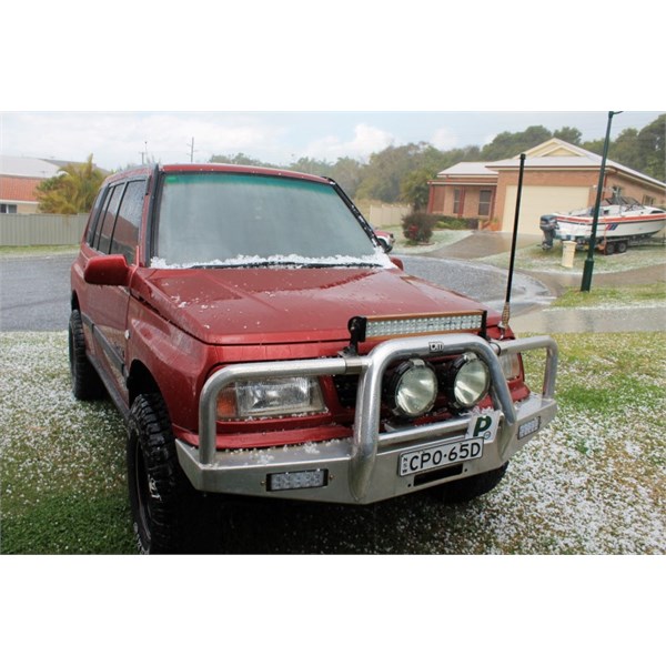

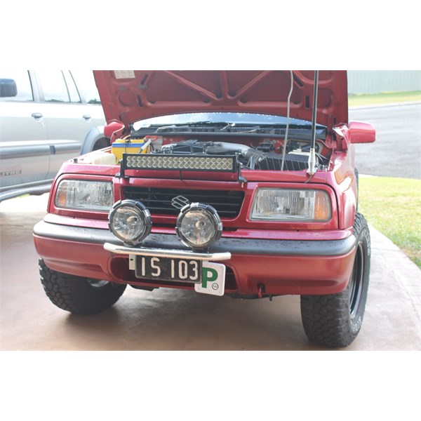

Follow Up By: Member - johnat - Monday, Sep 01, 2014 at 21:56
For information, the NSW RMS has stated that additional lights must be installed as "pairs" or engineering approval obtained. So, the pictured Suzi would be OK with the twin lights on the woosy little "bar" at the front, but the light bar would not be, unless approved by RMS engineering.
Actually, the lights on the bar might be a problem, as the bar is not a standard item for the car, and they are "outside the profile of the vehicle" - the terminology used for the recent push against bullbars in NSW. Some with lights, antennae, rod holders etc that are forward of the profile of the bar are illegal.
To OP, I suggest that you check with RMS (or equivalent in your state).
FollowupID: 822988

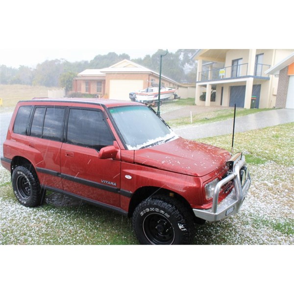

Sorry old photo, This is what it looks like now.
GU RULES!!
FollowupID: 823006
Follow Up By: Member - Frank P (NSW) - Tuesday, Sep 02, 2014 at 15:45
Did that hailstorm just happen?
Hope your zook doesn't get pock-marked.
FollowupID: 823007
Follow Up By: Dave(NSW) - Tuesday, Sep 02, 2014 at 15:52
Yeah Frank about an hour ago,
The Zuks alright it was the Commodore and Aurion were the worry.
GU RULES!!
