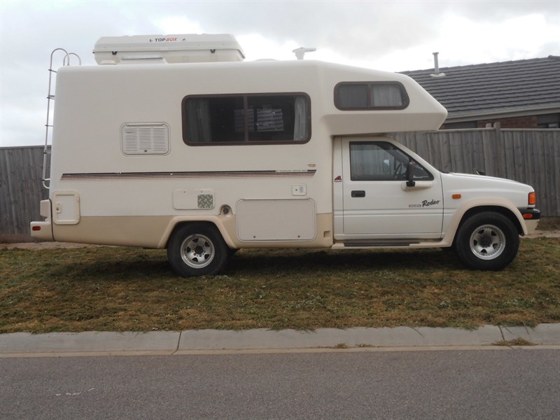

I just found a photo of your rodeo in your profile. Are you planning on putting the panel up the front where it slopes forward?
FollowupID: 823650
Follow Up By: Member - lancie49 - Sunday, Sep 14, 2014 at 21:05
If that is the vehicle, I think the easiest way would be 2 50x100mm aluminium angles Sikaflexed direct to the sloping area over the cab.
Mount the solar panels to the angles then drop the lot onto the roof in position.
I don't think I'd be going with the flexible panels judging from reports on other forums.
FollowupID: 823687
