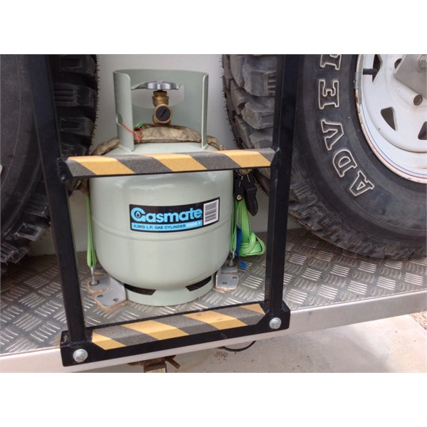

Our camper already has a locker, ventilated, for gas cylinders, but would be a bit small to fit 2 x 4kg cylinders together.
Using a couple of pieces of aluminium angle, I knocked up a mount for a 4kg cylinder, between the 2 rear mounted spares. Tie the cylinder on with a small ratchet strap. To save removing it to use, we found a 2.4M hose at Ray's or BCF, to replace the 1.8M one, and all good.
What Ron said, you have to be careful about any gas work done. Preferably by licensed fitter. As far as position goes, you would need to keep cylinder away from the exit to any sleeping areas, I'd suggest.

Follow Up By: Bob Y. - Qld - Friday, Jan 23, 2015 at 14:45
Steve,
Here's the photo as promised, but judging by Tom's post below, I might have to find another home for it. :-(
Still have room for 2 x 2.5kg cylinders in the locker, so this one may go up on pack rack.......see quite a few vehicles, through the tourist season, with their cylinders up there.
