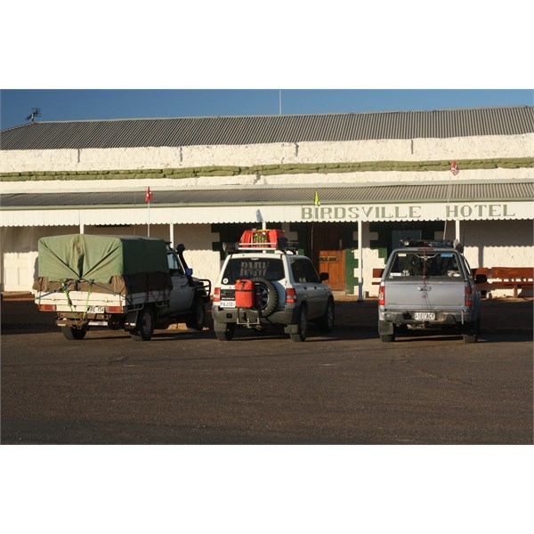

This is how I carry extra 40L's during the cooler months and never had a problem. I do get rid of it as soon as my fuel tank drops 40L's.

Follow Up By: WackyRaces - Monday, Feb 02, 2015 at 17:17
Sorry but cant see picture
