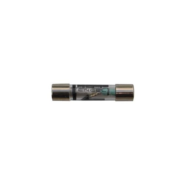

OBJ, there is also a thermal fuse in the plug on the leads. Is this what you are referring to as the 10A fuse? Is this OK? I had the same issue myself. Since then I have done away with the standard engel cig plug or twin pin arrangement and directly wired the fridge.
Check the thermal fuse.
Mick.
