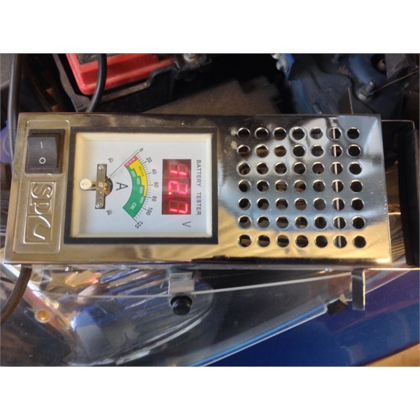

Follow Up By: Bob Y. - Qld - Thursday, Feb 19, 2015 at 10:30
OBJ,
In a past life, we used to load test batteries with a method that was both crude, and potentially dangerous. So I bought one of these, $80 from Bearing Service in the Isa. At that time the nearest auto electrician was either 400 or 500 clicks away, so it has paid for itself many times over.
Best thing since sliced bread! :-)

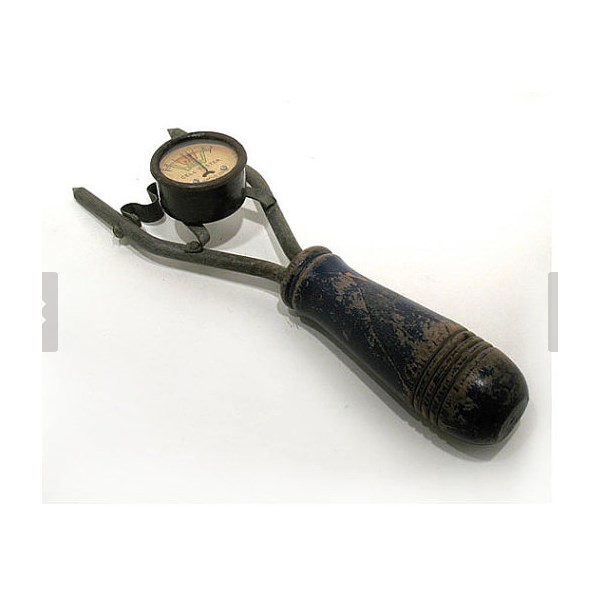

Follow Up By: Allan B (Member, SunCoast) - Thursday, Feb 19, 2015 at 12:12
That's posh Bob.
Back in the days when car batteries had the individual cells accessible i had one of these............
Applied to each cell in turn, incorporating a 2v meter and a heavy load resistor.
Best thing even before sliced bread! lol
FollowupID: 833905
