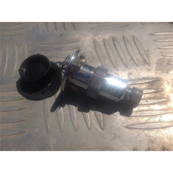

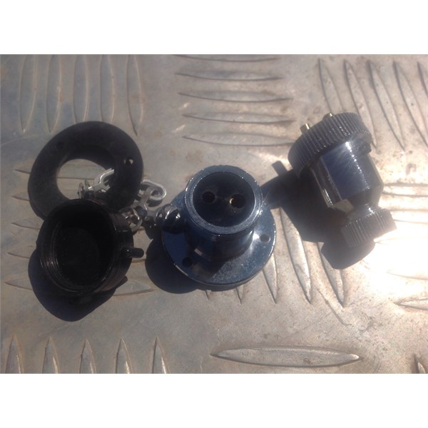

These Hella plugs/sockets might be what you need, Phil. From Hella Marine catalogue, and also available from Whitworths.
They are rated at 22amp @ 12v. Socket is only 31mm high(plug is 37mm long) so would be quite unobtrusive when you had the spare tyre mount off.
