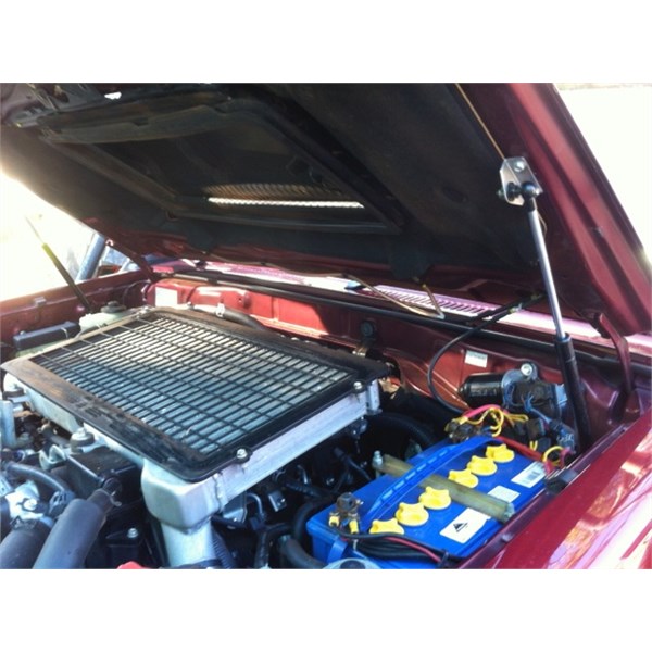

A simple and relatively cheap addition is some bonnet struts. I used the same ones as the nissan ute has bought from eBay. Bought the fittings from a trailer shop. I had to move the fuse unit on the drivers side down by about 30mm by adding a custom made bit of bent aluminium bracket.
Serendipity

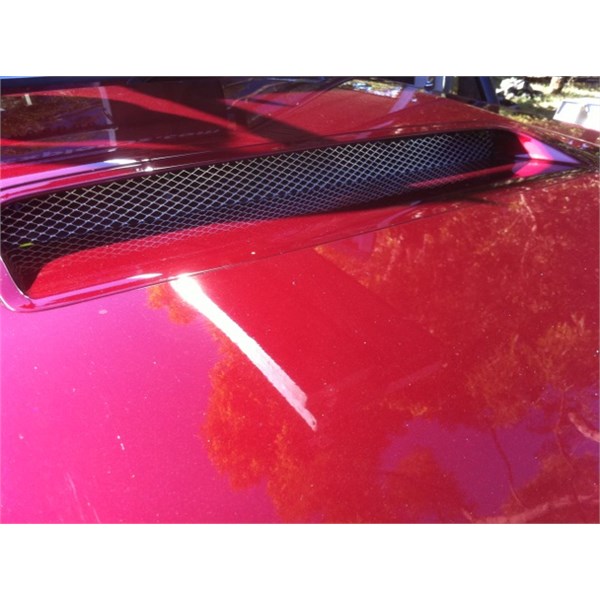

Another cheap one that is helpful. A bonnet scoop guard. You will find lots of leaves, twigs, bugs will enter here often at speed and start denting you inter cooler.
I bought some expanded aluminium mesh from super cheap - the sort that people use to add below their grill line for the look.
Serendipity
FollowupID: 838420

Yes, bonnet gas struts,best thing I've done, those bonnets are really heavy.

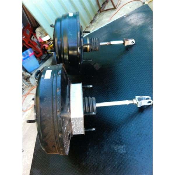

One of the better things if you are towing running heavy loads is to upgrade the brake booster. You can swop out the original for an 80series double diaphram booster and really increase your stopping power.
One of the better upgrades I did.
Look it up on Lcool where I posted all about it.
Serendipity
