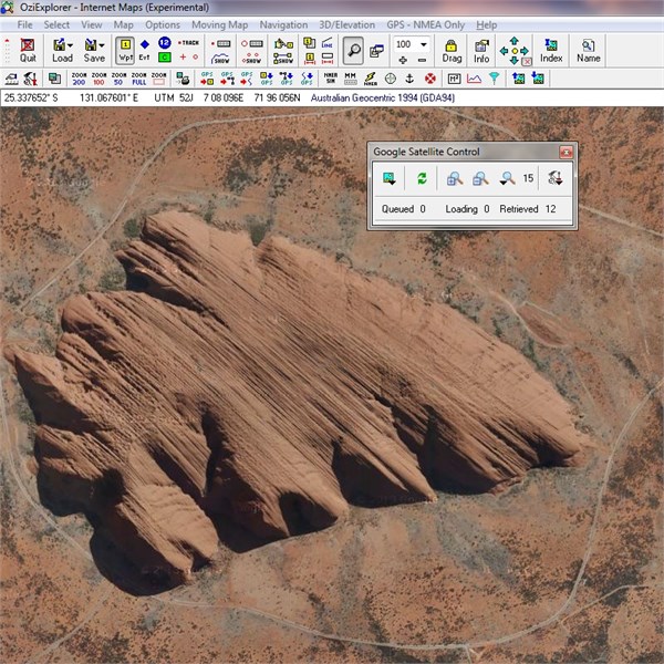

...for all those OziExplorer (PC version) users out there keep in mind you can open Google Earth images (and a few other map sources) directly into OziExplorer using "Internet Maps" - all explained HERE
So - you can do what Basecamp users (etc) are doing without the need to flick between GE and your mapping program - Just open OziExplorer load up Internet Maps and you can then trace tracks etc, save them as GPX (for example) and load them onto you GPS/Tablet/Nav device for later reference while on tour.
Also all the GE images you look at while online with OziExplorer are cached (saved) on your PC so you can view them later without an internet connection, which means if you have a laptop etc running the full version of OziExplorer you can reference the GE (or other) images while in the middle of nowhere (assuming they have previously been cached).
The cached images work with Ozi Moving Map so this is what the OP was chasing though as mentioned ..need PC version of OziExplorer and you need to cache all the images you want at the correct zoom level while online (note: I have never tried this so just what is claimed)
