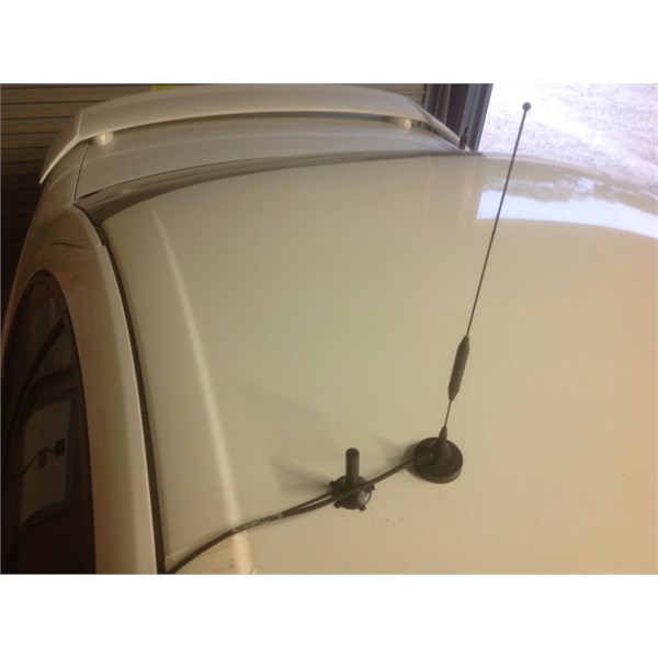

Reply By: Bob Y. - Qld - Saturday, Jun 13, 2015 at 11:37
Depending on how much you plan to use the phone in the vehicle, Tazbaz, you could go with a magnetic base one, that just involves running the cable through a door, and across to your console.
While I have a bulbar mounted one on my Landcruiser, I bought a magnetic unit for my sedan. It is about 5dB, 380mm long and being on the roof works as well as the one on the L'cruiser.
Have a patch lead that plugs direct into the Telstra (ZTE) T96 phone. Works well, though nobody rings me much. :-)
