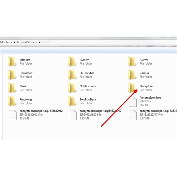

So connect your Monterra to your PC and you should see this..
Click on Internal storage and you should see something similar to this ....

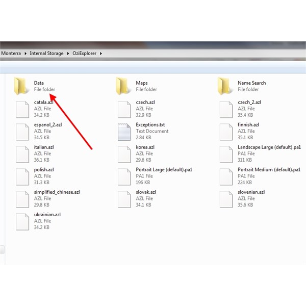

Click on the OziExplorer folder and this will appear...
Click on the Data folder to open. Copy the waypoint file from the PC into here (using Windows copy/paste - you dont need OziExplorer PC open to do this).
