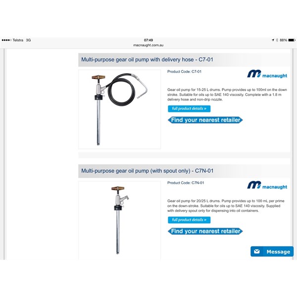

I buy both diff and gearbox oil in 20L drums, Roachie, and use one of these Macnaught pumps in each.
When the Boss is not working she kindly operates the pump, while I lie underneath, waiting for the inevitable overflow. :-)
AnswerID: 589821

I have one of those pumps, but I only buy my diff oil in small bottles.....the rear diff holds 4 "quarts" and the front only 2. So, I don't think that small quantity would be able to be sucked up with one of those pumps....but could be wrong.
FollowupID: 857829
