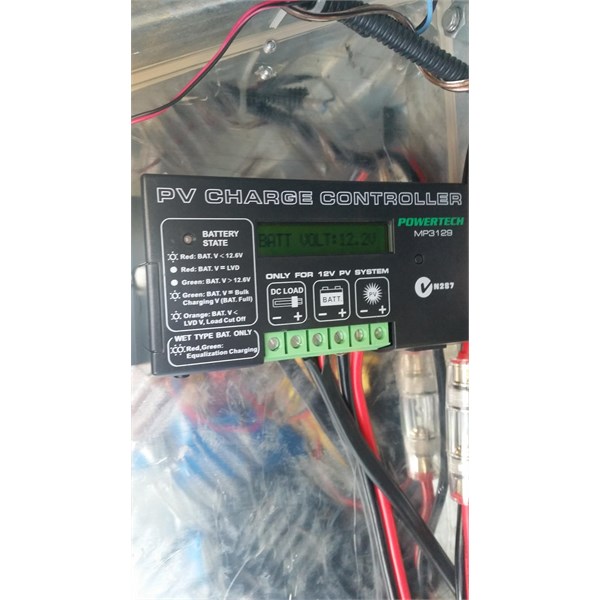

Camper already has a solar charger regulator installed, pictured.
Not sure if it's any good or not???
