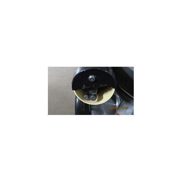

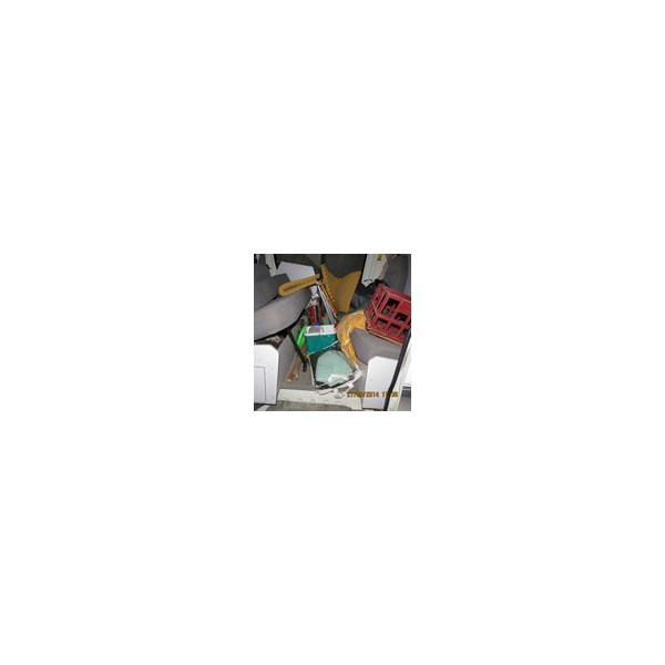

My beloved Hiace pop top, that I inherited from my father, has been broken into and trashed. He always kept it so beautifully. It is so sad. Was due to go to Kangaroo Valley Folk Festival at the end of the month.

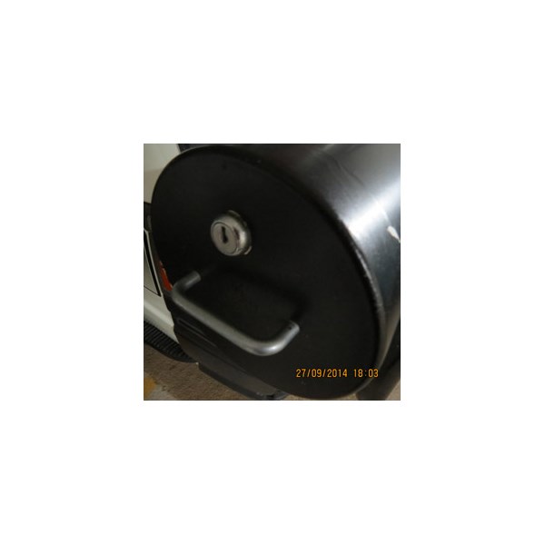

There is a long PVC canister on the front of the camper for fishing poles and tent poles, with lockable ends. One of the ends has been smashed and I don't know how to get a new end or where to go to fix.
Your advice how to fix this would be much appreciated. I am not a handy person.
Photo of the broken end, and the good one attached. Plus a photo of how my van was trashed.

Is that just a PVC pipe with screw on ends ?
If so, should be easy to source a new cap, drill a few holes and swap over handle and lock ??
If the threaded caps, should be able to take old one or part of to Bunnings and they should have one, that or a plumbing store.
A lick of matt black spray can paint, and away you go :)

They pushed over the end, not threaded.
I am recovering from an injury hopefully can find someone who can help me with the drilling and handle.
As a start will check out Bunnings.
Many thanks Zj

What is the exact diameter of the pipe? It looks like 90 mm storm water pipe to me. If so then you can get a threaded access coupling and a threaded cap to match. These are used by vanners to construct annex pole carriers. Cut your pipe back to suit. Remove enough of the black paint so you can glue the coupling to the pipe. The cap then screws onto the coupling.
Many of us don't bother with locking the cap. For locking you may be able to adapt the existing lock to fit. If not then the other way is to use a hasp and staple Mount the staple on the coupling and the hasp on the cap. The hasp is bent at right angles to go from the end cap over the top of the carrier.
If it is larger than 90 mm then plastic sewer pipe fittings may be the go.
Alternately you can get them ready made up. Have a look at this page. There is one pictured there. If you click on it you will find parts for it and also 150 mm pipe. If your pipe is 150 mm then this may suit you.
