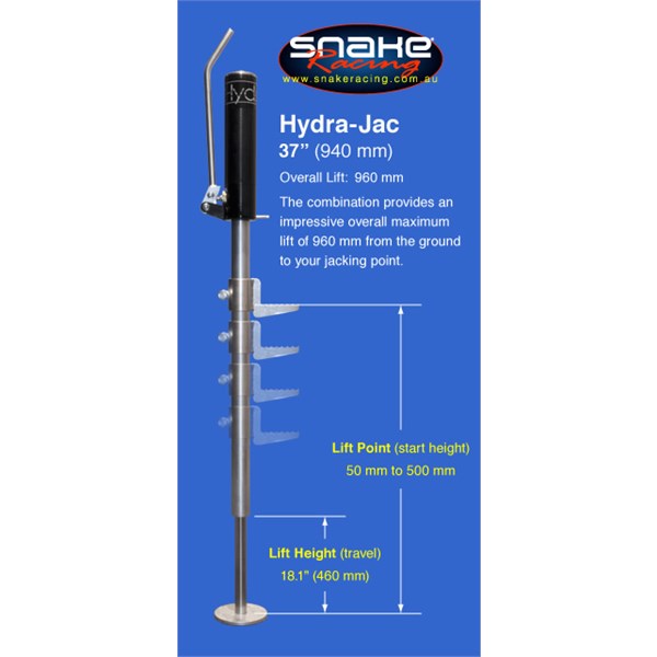

Reply By: Member - John - Saturday, Oct 10, 2015 at 07:25
or this, (sorry, you don't seem to be able to include more that one link in a reply). Hydra High Lift Jack

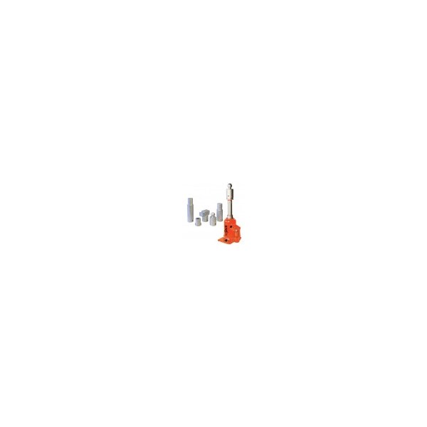

Reply By: Allan B (Member, SunCoast) - Saturday, Oct 10, 2015 at 11:05
I had trouble getting a hydraulic jack squat enough to fit under the axle with a flat tyre but with enough lift to provide clearance for an inflated tyre. Eventually I found this Masada 2-stage 150-240mm jack. It does the job perfectly.
