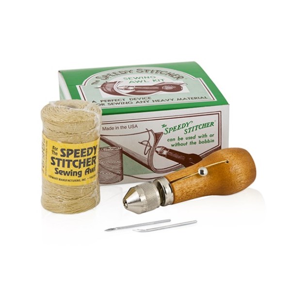

Many years ago I bought a Speedy Stitcher made in the USA for leather and canvas work. It has a wooden handle which holds a spool/bobbin of waxed thread and a metal chuck, like a drill, which holds a needle that also serves as an awl. I've made and repaired all manner of things with it. Not as as fast as a machine but once mastered, every bit as good and a damn sight easier than using two needles worked in opposite directions through holes made with an awl. A saddler might beg to differ. :^)
A search of eBay tells me you can still buy them. Craft or leatherwork suppliers might also stock them. HTH.

Agree fully I brought one many years ago have repaired packs made canvas bicycle panniers. fixed shoes and it work well.

+1. Replaced the suspension straps on a cavalry-style saddle while out in the bush.
