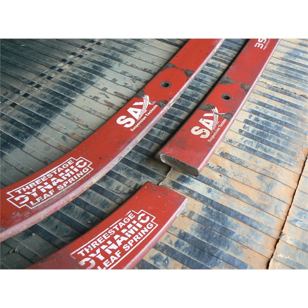

Follow Up By: Phillipn - Friday, Oct 30, 2015 at 21:22
This photo confirms what I was told re after market springs.
