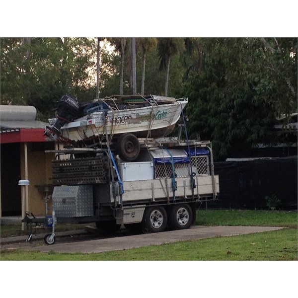

I am trying to talk my mate into forgetting about the strut thing and "upgrading" to a rig like this......................

Follow Up By: ian.g - Monday, Dec 14, 2015 at 11:48
The fork lift to get the boat down must be on the "A" trailer
