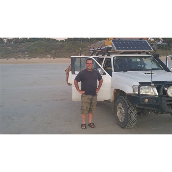

Solar Panel
I have put that panel on the roof rack of my car permanently fixed. The cable runs down the
snorkel and into a basic 10 amp regulator. The panel is a 95 watt from ebay.
I run a 40 litre Engel and a 50 litre CFX Waeco. I have 2 optima batteries in the car. I think around 66 amp each.
The solar panel and the batteries make me pretty much self sufficient and I can stay static for days at a time. I also run an 11 litre Waeco console fridge but if I run all 3 I run out of
battery power, so I only use the Console fridge when driving for chilled water/Chocolate Milk etc.
I did a trip a couple of years ago where my batteries died and without the panel I would have been stuffed. Obviously when driving I was ok then when i stopped I just parked to car into the sun which kept me going.
If I was doing it now I would do as some of the others have suggested and look at a really good MPPT Controller.
There are heaps of options out there so I suppose a lot depends on what type of trip you are doing.
Good Luck!!
AnswerID:
593898
Follow Up By: Grizzle - Thursday, Dec 17, 2015 at 14:10
I should have mentioned that I have just completed a
Kimberley trip. That picture was at the the start on
Cable Beach,
Broome.
