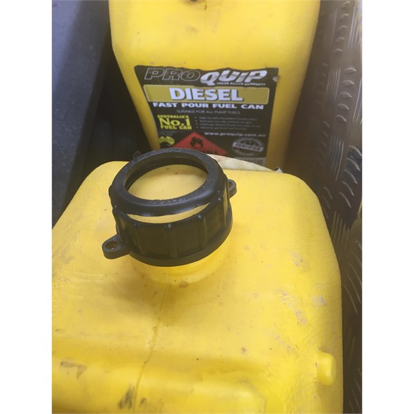

Just a warning to members who may have purchased the 5Ltr proquip plastic fuel containers.
I purchased a couple of these containers just before Christmas, normally I store my fuel containers in the garden shed but as I have purchased more and more petrol powered tools have recently decided to store them in the garage. There was a nice spot under the ducted vacuum where they could live but decided not a good idea so put them on the other side of the garage.
A couple of days ago went out to the garage and smelt petrol, on investigating found both containers to be swollen and a pool of petrol around one. On investigating found the plastic cap had split on one of the containers. These containers have a pouring spout which is stored in the container, the plastic spout has a seal on it, you insert it into the container and then screw on the plastic cap to seal it. This arrangement allowed the pressure in the container to force fuel up the spout and then through the crack in the cap resulting in a puddle of fuel.
On contacing Proquip I was told that they had a faulty batch of caps last year and recalled the the containers, I did a search and the only recall info I could find was on their website.
If you have purchased one of these cans in the last 12 months or so I would visit their web site and see if your container is fitted with the defective cap.

HKB, it's not just the 5 litre containers, the 10 litre and 20 litre are affected as well - as it appears they all use the same cap.
The containers are not being recalled, only the caps - and if you present with a faulty cap, you will be supplied with a new one.
The faulty cap was produced in July 2014 and according to the recall, could have been sold between 28th July 2014 to 8th February 2015.
If you bought yours just before last Christmas, then they are part of the faulty batch that have missed being recalled.

Yep. Two types of caps were recalled. This link by proquip gives the details on both types and how to recognise them. I personally think the lid design is ridiculous, so have replaced the lids on my 20L platinum jerrys with the one piece caps. Who wants the spout to sit in diesel? And I have a couple of older 5L Proquip containers (made in USA) which I've thrown away because of caps cracking, so it wasn't just July '14 production.

Thanks for the tip. Just checked mine and found all three storing diesel were cracked. Empty drums were okay. The production date on the cracked drums is 11/14 so Pro Quip need to revise recall dates.

The cap design is simply a poor design. You should be able to do caps up tight.
I have multiple Rheem black poly jerrycans that are all over 20 yrs old, that get used weekly, and I do the caps up tight - and they're solid caps with the ability to be done up tight.
You can get a lot of pressure in a jerrycan with high ambient temperatures.
There's a lot of rubbish on the market by way of fuel containers - and every year some designer finds a way to make them cheaper.

I agree with you Ron. Poor design. I have three 5L Proquips I use for Oil and Coleman stove fuel and 2 of the 3 have the same cracks as yours. No good enough for a petrol container. The later caps have the ribs come up higher to provide more strength but it looks to me that the problem is the contact surface is not flat, so just cracks on one side.
