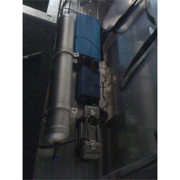

I have a twin set of cheap compressors and a 5 gal aluminum tank in/under the Troopy. I made an engine driven rig on our 80 series in Saudi where I used a DC fire extinguisher as a tank, worked great. No room under the Troopy hood for anything much. I was looking at my current set up yesterday wishing for a Boss 06. The best compressor would be a Boss brand 06/07 {~250$ and up] as they are rated for continuous operation, way out run the others - IMO.
