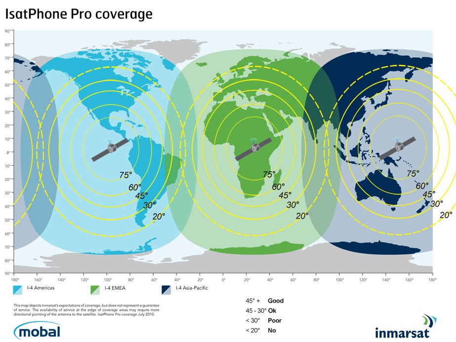

Reply By: Sigmund - Monday, Feb 22, 2016 at 16:20
Here's a rough guide to Inmarsat's satphone satellite showing angle of elevation in various parts of Australia. (I've used mine in the Sth Island of NZ - no problem where the sky was fairly open).
AnswerID: 596506
