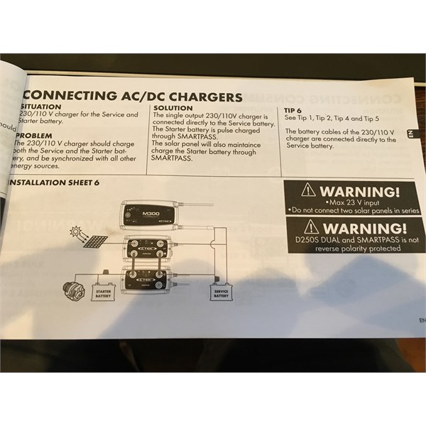

Reply By: stacey s1 - Friday, Jun 03, 2016 at 13:00
just an update to my question about 240 volt charger inline with c-tek DC to DC charger. If every thing else fails read the manual. lol
