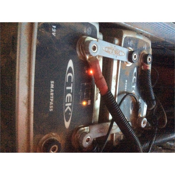

Hi all
Below is a message from a mate of mine in the Kimberly. Would appreciate your feedback so we can help him out.
Lyndon
I have a ctek smart pass connected with the D250s dual to my 2x 130ah agm batteries. I am not getting the full charge from the cteks ,when I had a look the ctek smart pass is showing an error light with the flashing light on #4 under the battery icon
Which suggests to relocate the unit because of heat,
The unit is fitted beside a set of drawers in the rear canopy of my hilux where I didn't think it is getting too hot
It also suggests to reduce the consumers connected, I've only got one 40ltr Engel connected .
And it also suggests charging the service battery which I have also done.
The error still is still on?
Can the error be re set or does the unit need replacing? It is approximately 2 years old and has been working fine until now.
I am currently traveling in northern Australia and can't find a stockist to speak with.
If the unit needs replacing should I just disconnect the smart pass and use the D250s as a stand alone unit for now?
Thanks very much

Gidday Peter,
If there is a heat issue, it would probably depend on where the temp sensor is. It should be located on the battery, and if so, it may be the the battery is getting hot or the temperature in its compartment is too hot.
In the interim, you can just disconnect the joining bus bars and refit the battery lead to its output on the D250S.
Does your mate have a smart alternator on his car? If so, part of the problem (Smartpass aside) is that the D250S will cutout once the voltage drops below its trigger voltage. Ctek's solution is to fit a relay to switch the solar and alternator inputs to the solar terminal on the D250S.
That renders the Smartpass obsolete because the D250S is now limited to the max current of the solar charger (20A, from memory).
Hope this helps.
John.

'Too high a current through the relay warning' would suggest one of the batteries is stuffed or a dicky connection somewhere. I'd be checking them individually first before doing surgery on the ctec.

Whoops
Sorry should have mentioned, he has disconnected the batteries, charged them, then done a discharge test. All seems OK from that point.
