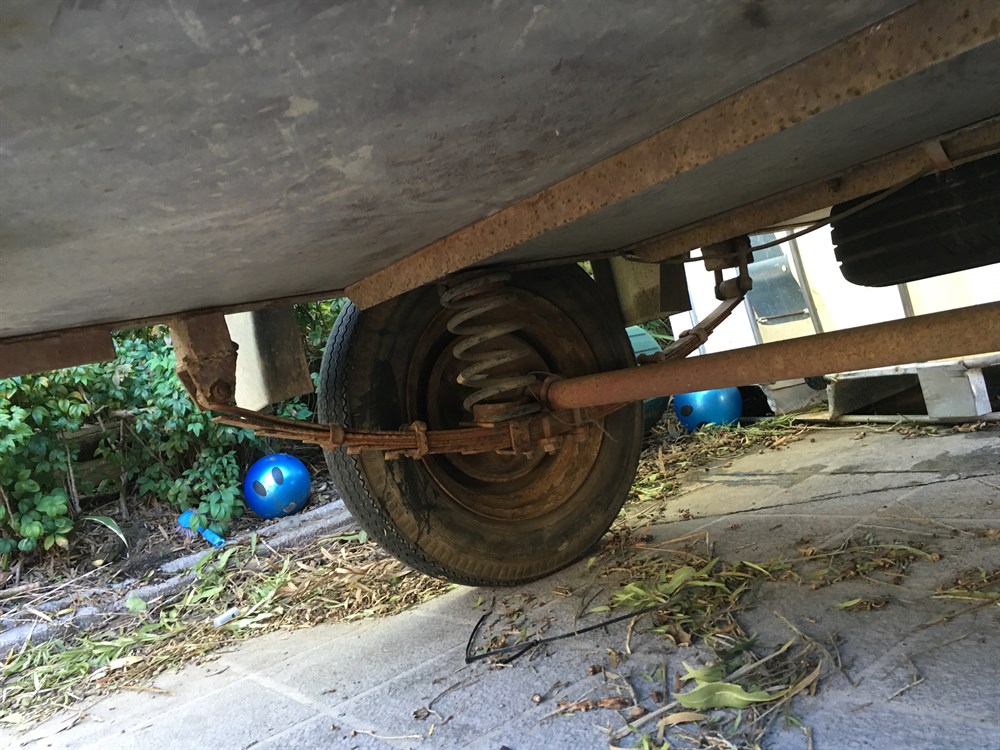

Hello all just looking for some trailer wisdom. I am building a camp trailer 6 x 4 with rooftop tent, tool box and few odds and bits. All up maybe 350 to 400 kgs in the trailer. The trailer is an old steel frame with timber side's and the rego gives no weight but I would think its around 400 kgs.
My question is, What would be the best option on strength vs smooth ride in a replacement suspension. I have springs and coils on now but they are old and need replacing. Was looking at these on e-bay.

Crawl under the trailer and have a look how it is constructed. A lot of old 6x4's have what appears to be a solid draw bar, but it is welded onto less than substantial structure. Sometimes the cross members under the load area are just folded sheet metal.
Adding a tool box to the draw bar will add more stress to this area and it is not uncommon to see a box trailer that has a bent draw bar, or has folded under the weight.
If you have the facilities and welding experience, then I'd suggest that you "renovate" the trailer and make it more substantial as building a new one and getting it registered can be a pain. On mine I replaced everything, except the number plate and the chassis number.
Slipper springs work OK, just weld a 100 x 6mm wear plate to the chassis, rather the little square your average box trailer has for the spring to run through. They aren't as good as eye to eye leaf springs, but you are unlikely to wear them out with occasional use. The less complexity, the better most times.

Great stuff. I have not started the renovation yet as Im still in the research mode however I have purchased some 33 inch tyres to match the Toyota and I have the arb tent. I like the retro look of timber sides so ill keep it. However I will spend the money in the suspension and everyday camping concerns. The frame is welded 25mm sq tube and the springs are eye to eye with coils. Some pics

Surely this is a troll??
I don't like to be pessimistic, but I'm afraid that I agree with Bigfish that you are wasting your time. That trailer would struggle to pass rego, let alone the rigors of off road use.
The draw bar is too thin and isn't attached to the trailer adequately. Adding a tool box and I'd predict that it will fold where the braces are welded on 1/2 way. Having a draw bar that runs all the way under the front of the trailer and is welded to the front suspension pivots is a better plan.
Yes, the suspension needs work, those dropped pivot points are just nasty.
Again, I think you would be better off starting again, even if you stick with the angle iron frame so you can have the timber infills, as the current chassis, in my view is inadequate for what you have planned.
I don't go and buy the best there is, I think I am rather frugal (although my wife says I'm a tightass) and on this job I think you will be throwing good money after bad to get something that will still be inadequate and more than likely leave you stranded. The whole point of a trailer is to carry stuff you can't fit in the car, so what do you do with all that gear when the draw bar snaps off out in the scrub 200km from home?

Looking at your trailer I would suggest that you never venture onto dirt roads. It is very lightly built and the odds of it breaking up on a corrugated road would be very high. In my opinion you would do better buying a new trailer that is safer, stronger and better equiped for what you want. Sorry mate but your asking a little boy to do a mans job.

lol, the power of positive thinking, Look I could just go out and buy the best thing going like I always do but I wanted to make something this time. I do plan over hauling the frame and Im sure ill spend more on this then if I just bought new. Its the journey right

Positve? Positive it wouldnt get 100 meters ,loaded and off road. Mate you will need an entirely new frame suspension and floor, sides and draw bar. Get some plans for a total new trailer and enjoy the project. No good throwing money at something that would cost you $100 on gumtree.

Go for your life Stacey, I did the same thing over 10 years ago and have had no problems. Believe me, my trailer has been to hell and back more times than I can remember. I also, had plenty of 'advice' from 7 star campers who wouldn't know a screwdriver from a teaspoon....lol.
Strengthen the subframe as you see fit. Common sense works better than any engineering degree.
The 750kg kit will be the go, but if Chinese wheel bearings are included, throw them away. While you're at it go spring over axle, works for me, especially in extreme off-track situations.

Lionel, did you look at the images of said trailer?

G'day Hoyks, I certainly did mate and it appears in much better condition than mine when I started the project.....lol.
I was looking for a more compact, lighter and robust unit because I knew where I would be taking it. Budget at the time was a huge factor also.

I agree with Lionel, that trailer has potential. The chassis looks pretty pathetic so I would make a new one with a new strong drawbar, then bolt the wooden/angle box onto it. It will be strong as anything and still look like he old trailer!!!
