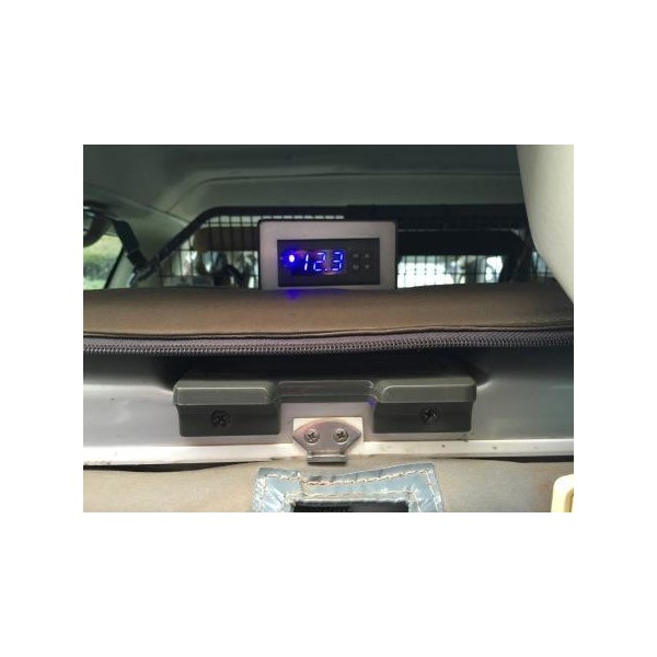

http://www.ebay.com.au/itm/Digital-Temperature-Controller-Thermostat-12V-10A-Switch-40-f-120-f-w-Sensor-/400893167986?hash=item5d57184972:g:nvcAAOSwZ8ZXB6yK
Wire it in line with your power cord with anderson plugs, probe is easy to fit next to engel temp sensor. Then if it goes bung you an revert back to original. There's a few mobs on ebay sell them. I've had mine fitted for 3 or 4 years and done some long hard kilometres. Never missed a beat.
It switches power on and off to the whole fridge so you are not messing with the fridge internals.
I put it in a small enclosure and cable tied to lid of fridge although you can put it anywhere really as long as the probe will reach.
