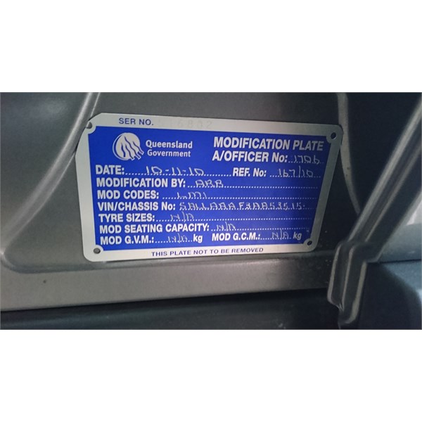

Reply By: Member - TonyV - Sunday, Jul 17, 2016 at 10:30
In QLD needs to go to an engineer for compliance, then a blue plate fitted to be legal.
As this is a post registered upgrade should it be sold interstate it would need to be engineered again.
If on a new vehicle and done pre-registration it would be legal in all states.

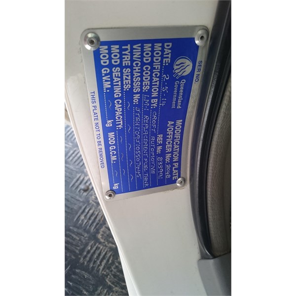

Reply By: Member - TonyV - Sunday, Jul 17, 2016 at 14:47

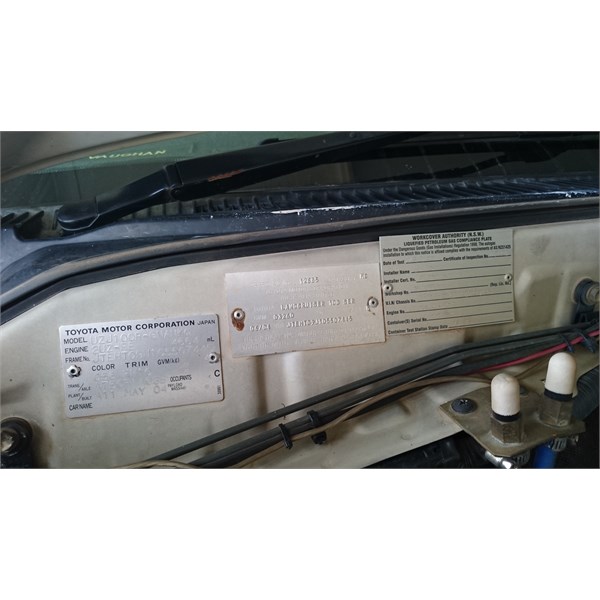

Phil,
From new, 3 x plates, 2 from manufacturer and one from the LPG installer both normal alloy plates black or embossed writing.
The LPG was done pre-registration.
The Blue plate is issued by a certified engineer, the blue plate is an after registration plate for additions, in my case for a long range fuel tank.
Both my vehicles have blue plates.
