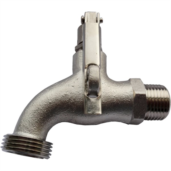

I had trouble with one of my plastic taps so I replaced them both with these type and I slip a rubber chair stop over the end to help keep dust out.
AnswerID: 603839

Thanks Batts....
I had one like that on the camper trailer and never had any issues.
I'm not sure whether one would fit on current van (between the tank and the side of the chassis rail), but it'd be worth measuring I guess.
