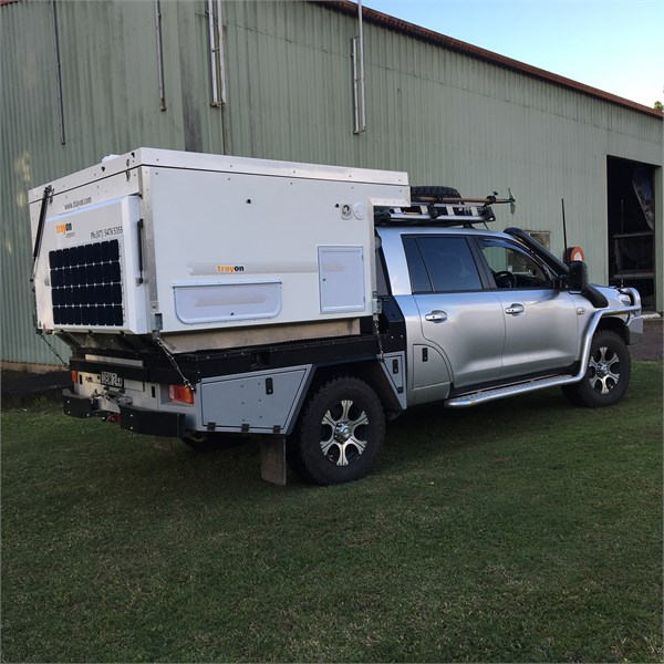

Reply By: Member - Noah273 - Wednesday, Sep 07, 2016 at 15:21
Hi Coolie,
We have a light weight panel by Solbian. I've attached a link to their website.
https://www.solar4rvs.com.au/solbian-australia-.html
AnswerID: 604199
Follow Up By: Coolie - Wednesday, Sep 07, 2016 at 19:45
thanks for this. I did look at their web site and wondered. I gather you've had no probs with them ? How long have you had them?
FollowupID: 873919
Follow Up By: Member - Noah273 - Wednesday, Sep 07, 2016 at 20:08
We've only had it since mid August. We stuck the solar panel onto the back of our Trayon Camper shower so it's on permanently. It has a non slip finish over it as they use them on yachts. Fits perfectly onto our shower roof which folds down when not in use.
FollowupID: 873920
