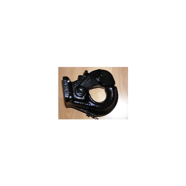

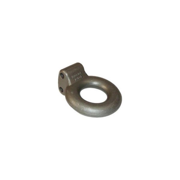

That's interesting Splits. I used to sometimes pull a trailer around Woomera with a landrover with a ring coupling and do not remember any particular noise. But then maybe I did not notice it above the landrover rattles! lol
Is it possible that some people proclaim them as "noisy" simply on their appearance without ever having experience?
I thought that this coupling was available with a locking pin which prevented the ring from twisting during reversing. Using this pin would be no more trouble than disengaging a trailer override brake I would think.
Come to think of it, my Woomera coupling had a ring that was fixed and could not twist. Looked like this I think......
And the hook was not a pintle but was just a plain hook like this.....
