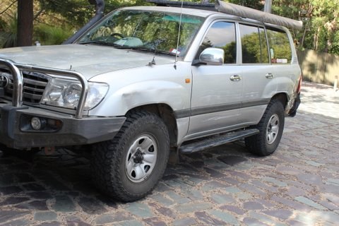

Ours does extend a way forward but that is only about 300mm, so there is still plenty of strength there.
But saying that, We are both well aware of it and "drive accordingly". I hate that saying, but it is true for the awning. We have never hit anything more than small leafy branches with the awning.
And yes the right hand side does get more than it's fair share of pinstriping.

Haha Phil. That looks like a javelin, or maybe even a rocket launcher!
Keep up the "accordingly" driving. lol
FollowupID: 874332
Follow Up By: vk1dx - Wednesday, Sep 21, 2016 at 10:49
It's just the 2M one. Why get a tiny one when a bigger one is more useful.
