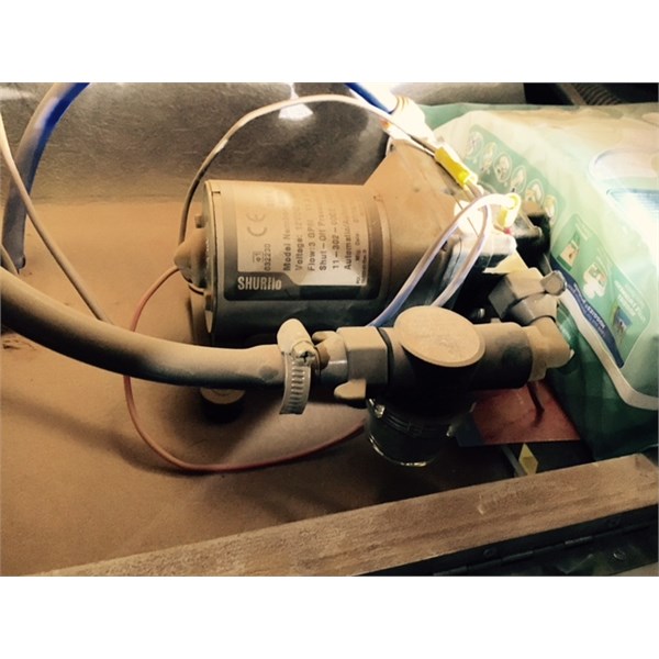

Dean, I have one in my van in the dusty cupboard.
It has a filter on the inlet pipe.
In the plastic bowl is a mesh filter. I have cleaned our several bits of black plastic and other gunk.
I guess not are all the same but here is a pic of the pump and filter
AnswerID: 604618
