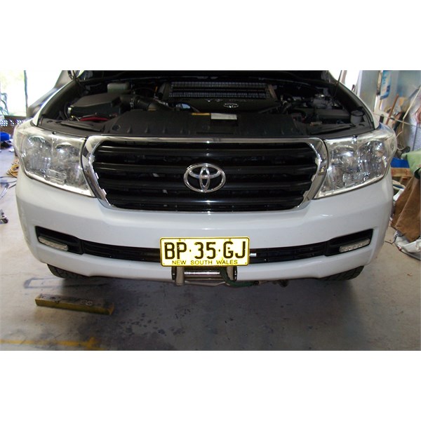

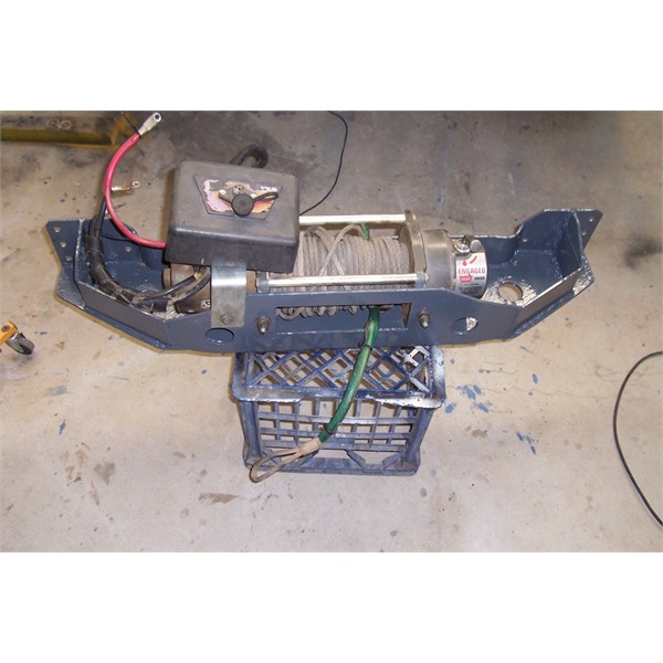

We have a 2008 200 series TTD and I didn't want a bulbar either, so I stripped the bumper down and had a look at what could be done.
I made up a cradle, as per photo, and mounted it this way.
If you were to enquire at Toyota they should be able to supply you with one.
Regards Jim-Bob.

Very nice Jim Bob.

Follow Up By: TomH - Monday, Oct 17, 2016 at 13:43
Is that actually legal. The reason I ask is you may not modify or interfere with the integrity of bumper bars etc because of airbags and crush panels.
It is even illegal to weld a bracket in to have a towball at the front to maneuver a van as it alters things as above.
I would think that at the very least it would require certification by an engineer.
Unless as per your last sentence it is a factory supplied option.
