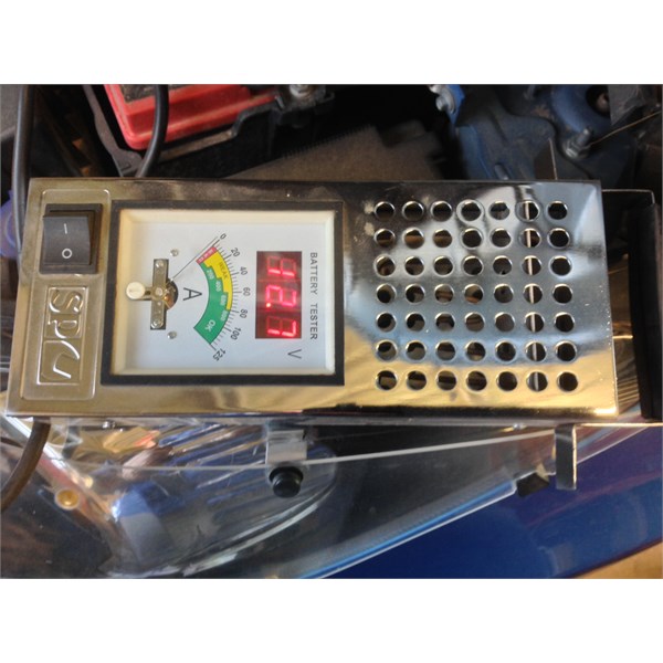

Follow Up By: Bob Y. - Qld - Monday, Oct 24, 2016 at 10:32
Get yourself one of these and you can test your batteries in situ. Only about $80, and don't weigh much.
FollowupID: 875110
Follow Up By: The Bantam - Wednesday, Oct 26, 2016 at 10:59
Yeh those old toaster battery load testers are better than nothing ...... had one for years ...... but they are hopelessly inaccurate.
I have a carbon pile and a digital analiser for comparison ........ the toasters will show bad or poor batteries as good more often than not particularly if they are bigger batteries.
there are hand held digital battery analisers that are pretty reliable and way way cheaper than they once where.
OR .... charge it up and take it to you friendly battery shop ..... most of them will have either carbon pile or a digital analiser or both.

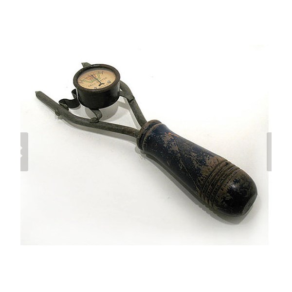

In the 'Good Old Days' when the batteries had the cell links on the top we used one of these:
Tested each cell individually.
Ahhh, the Good O'l Days!

Yes folks .. that is what a "Tong Tester" looks like ..... a clamp meter is not a tong tester.
FollowupID: 875392
Follow Up By: Allan B (Member, SunCoast) - Thursday, Nov 03, 2016 at 09:54
Errr, did someone say it was?
FollowupID: 875394
