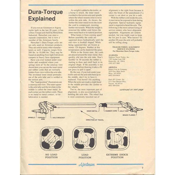

I have found a picture/article explaining the rubber components if there are readers who are not familiar the system.
bill
